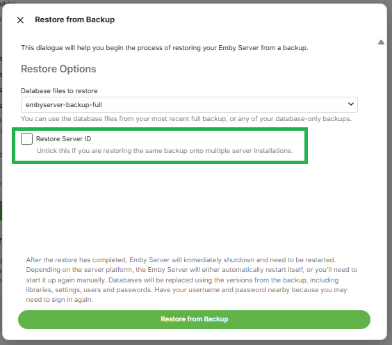

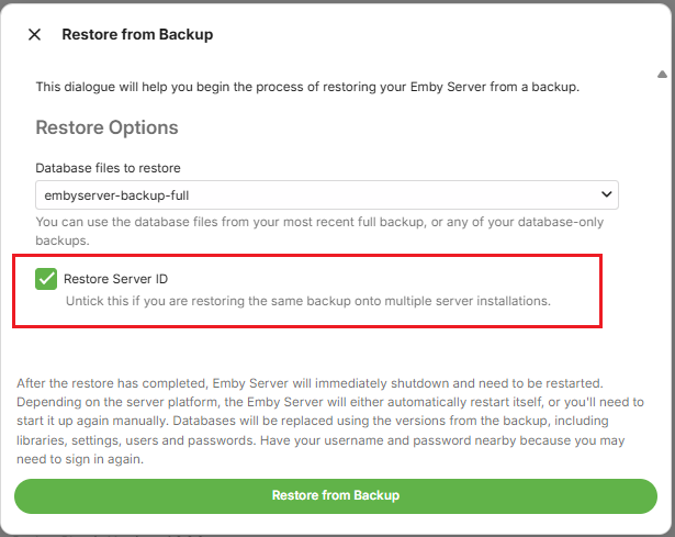

    You will have the latest full backup preselected: "embyserver-backup-full".
    As this is an additional server, make sure the "Restore Server ID" is NOT ticked.
