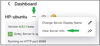

    If the Emby Server is not launching due to the corruption, please refer to Server-Data-Folder for establishing where the Emby Server data is stored. The database files are in the "data" sub-directory below the path shown in the support document.
    Alternatively, you can find the path by using the "..." top menu right above the server information box in the Emby Server Settings Dashboard.
    Corrupt Db1

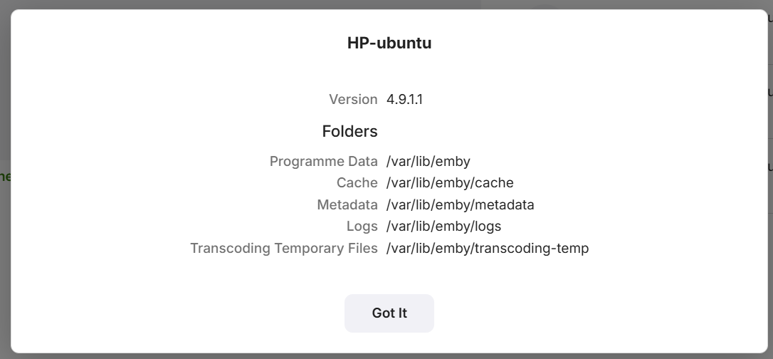

    Click on View Server Info.
    The database files are in the "data" sub-directory below the Program data path shown.

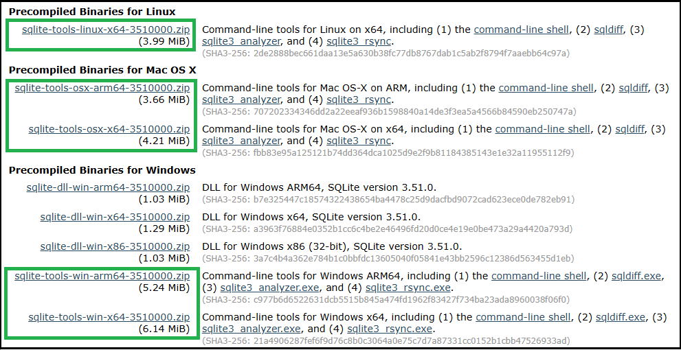

    This step will require the use of the Command line shell for SQLite3 tool, which may be pre-installed on some platforms. It can be downlaoded as part of the Sqlite3 tools from https://www.sqlite.org/download.html. If you prefer a graphical based editor, you can download DB Browser for SQLite which is available for most platforms. The instructions given in this document are for the official SQLite3 tools provided by https://sqlite.org.
    Note
    On NAS platforms and for Android Emby Server, you may need to copy the database file to a computer and do the integrity check and repair on the computer and then copy the file back. Access to the database on NAS systems will require enabling & using ssh, and adb & enabling Developer Options for Android.
    The following shows the available sqlite tools binaries for download:
