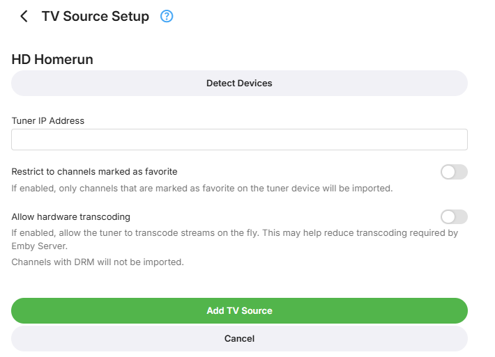

    Click the plus sign next to TV Source in order to add our first tuner. We will then be presented with a screen that allows us to choose the type of tuner to add. Select HD HomeRun from the drop down list of choices and then click the save button.
    Emby will search your network and present all HDHomeRun devices it finds on your network. Here is a example showing two Primes and one Quatro automatically found.
    In this example we are going to setup OTA (Over the Air) using the HDHomeRun Quatro. Click the Quatro (3rd on this list).
    Emby will start the setup of this tuner and will provide you with the ability to set a couple of options including: The ability to import all channels or only FAVORITE channels (already configured on the tuner itself). See configuration of HDHomeRun favorites below for more information on using favorites.
    The ability to use hardware transcoding on your tuner. Note: this is only supported on HDHomeRun EXTEND models.
    For this example using a Quatro we will enable the restriction of favorite channels and disable the hardware transcoding option. Once we’ve set our options the click save button and we will have added our first tuner.
