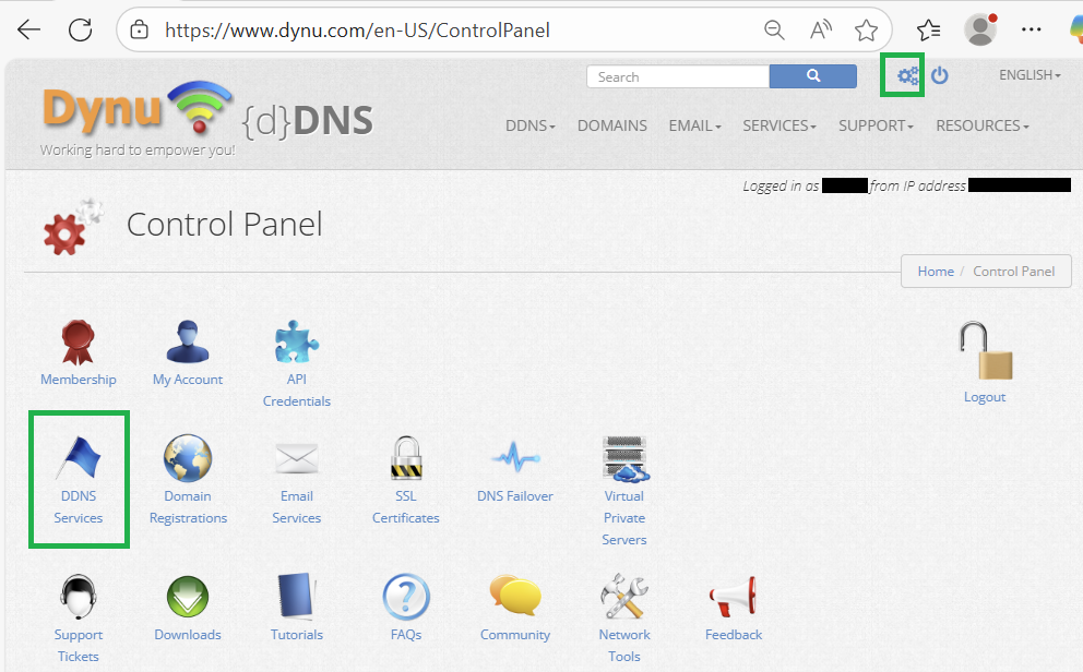

    2. Login to your account and open the Control Panel

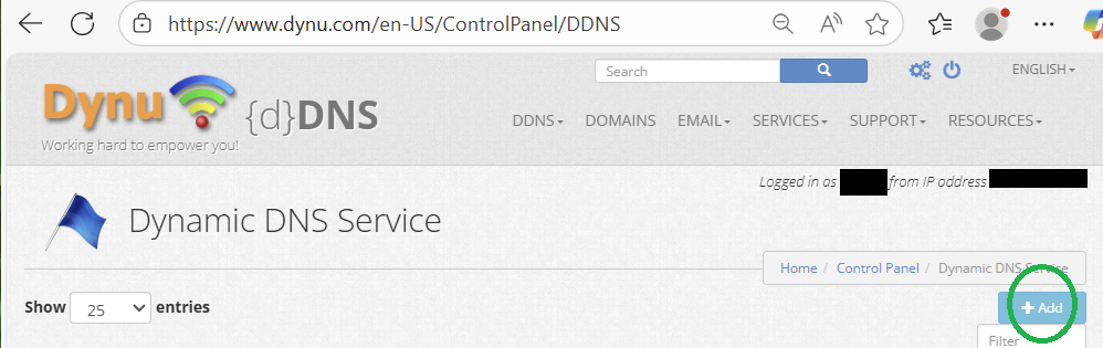

    1. Select "DDNS Services"

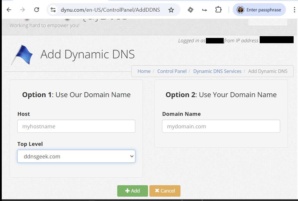

    2. Click on "+Add" to add a domain to the Dynamic DNS Service.

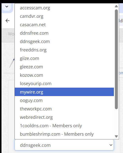

    Next, either choose a free domain name provided by Dynu, selecting one of the many Top Level domain names with your hostname as the prefix, or adding a domain you already own.
    The following shows examples of available Top Level domain names for a free domain name provided by Dynu.
    1. If adding a free domain from Dynu, select your preferred Top Level domain and enter the prefix "Host" name you wish to have.

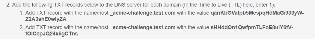

    2. Select Manual Verification (DNS) > Manually verify domain. We now have 2 TXT records (step 2 on the SSL for free website). We will copy back the TXT records to the domain provider. Leave the SSL for free page open. We will come back to it.
    1. On the domain provider website, select your domain > Manage DNS. Let's create a new TX record. Repeat the steps for both TXT records on SSL for free. Your information should look like this.
    For Dynu DNS, login and open the Control Panel and select DDNS Services, then select the domain from the list of domains for your account, and click on DNS Records and then fill the template for Adding a DNS Record. In the Node Name field replace the preset "www" with _acme-challenge. For the type field, open the drop-down and select "TXT - text". In the "Text" field, you would enter the text character requested for the certificate domain verification process.
    You should end up with a TXT DNS Record like this - these are just examples:
    Type: TXT.
    TTL: 300 (if you can set it to the lowest possible value).
    Target: qariKbGVafpb5MespqHdMaGi933yW-Z2A3shE0wIyZA

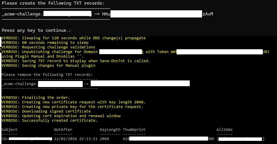

    You would then get the TXT record to add your domain DNS Records for the DDNS service.
    Exmaple of response from Posh-Acme:
    Please create the following TXT records:
    _acme-challenge.<your domain> -> xxxxxxxxxxxxxxxxxxxxxxxxxxxxxxx
    Press any key to continue.:
    where xxxxxxxxxxxxxxxxxxxxxxxxxxxxxxx would be the TXT string displayed by Posh-Acme that needs to be in the TXT DNS record.
    Now login your DDNS service provider, eg https://www.dynu.com and click on the Control Panel button.
    Click on "DDNS Service"
    Click on your domain name

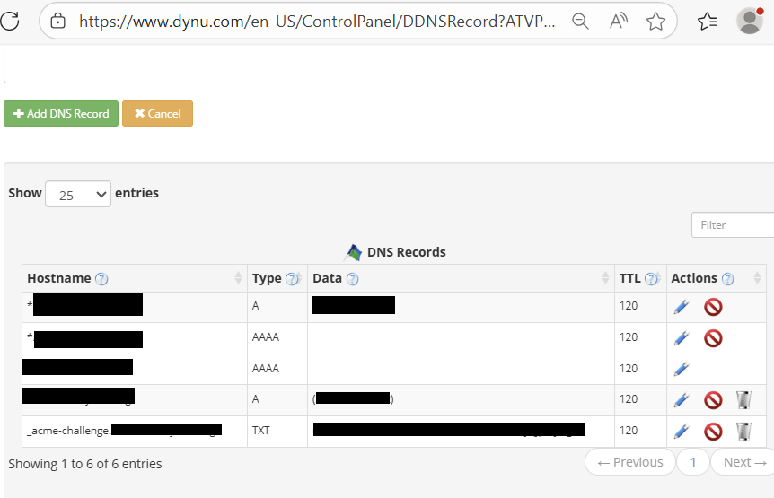

    and now click on "DNS Records"
    You will see a number of DNS records of Type A and AAAA. You will also see a public IP Address. Check that this is your WAN/Public IP Address.

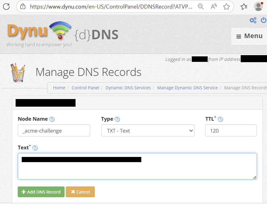

    You now need to add a DNS Record.
    In the Node Name field, overwrite the preset "www" with "_acme-challenge" In the Type field, select "TXT - Text" from the drop-down In the Text field, paste in the text characters returned by Posh-Acme above. Now click on "+Add DNS Record"
    You should now see a new DNS record added with the name "_acme-challenge.your-domain-name"
    Now go back to the Powershell session and hit enter to continue.
    Posh-Acme will now sleep for 2 minutes and then auto connect to your DDNS provider and validate the DNS entry and confirm ownership of the domain through that.
    When validated, Posh-Acme will now request that you remove this DNS record and it will confirm the certificate creation.
    Go back to the DDNS service DNS Records page for your domain, and for the _acme-challenge.your-domain DNS record, click on the recycle bin icon and confirm the deletion.

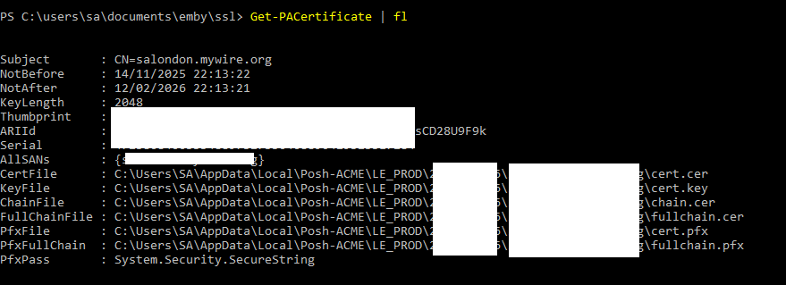

    To see where the certificate files are stored by Posh-Acme, go back to the Powershell session and enter the following command:
    Get-PACertificate | fl
    The file that you will need for Emby Server is that in the path for "PfxFile". Copy the file for where you want to keep the Emby Server certificate and you will also need the password you specified on the New-PACertificate command.
